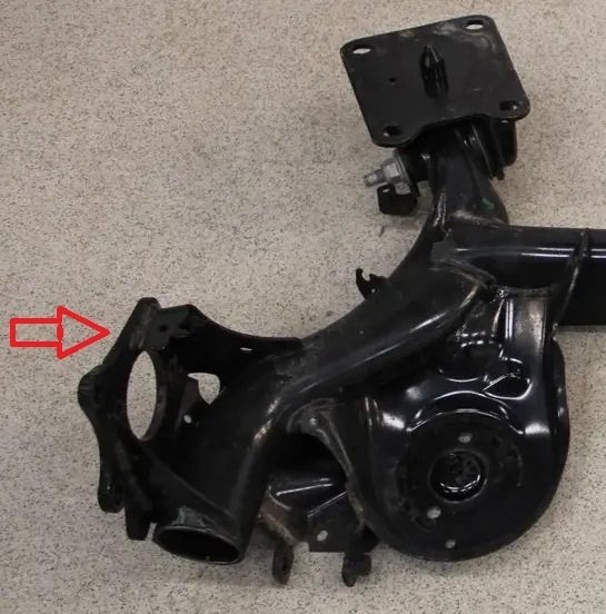

Something that might help down the road if one can locate the dead axle swap, Not sure the Connect rear axle would work as it might be to long. But if you're switching to the dead axle and need a bit more camber. you could be looking at either rewelding the hub plates locate don the dead axle or add in camber plates which is what we're looking to do ourselves.
I mean if I had the time and money, id buy a new/used dead axle and just have the hub plates repositioned. Adding the camber plates would grain you apporx 1.5° where as modifying the dead axle, one would gain more just depends on how close the tires could be to the body or other suspension components.
https://whoosh-motorsports.myshopif...amber-plates-kit-2014-fiesta-st-free-shipping
One more thing to add, even with a dead axle, you still may need a sway bar, but as of yet I've not located a sway bar that can be used in this instance. I have seen something that attaches to the lower coil spring perch. but can't verify.
