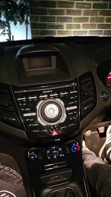

I get into my car and normally the screen would come on and radio turns on when I start the car. It has now stopped doing this. This happened about week and a half ago
The Sony radio screen is blank and no buttons seems to respond and nothing from radio
I took the fascia and dashboard apart to get to the head unit and unplugged and plugged wires back in. I can hear the cd drive spin up as it get power but still unresponsive with buttons, I cannot eject my cd. Hazard lights come on and door lock button works so power is getting through in that area

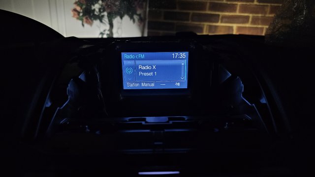

I purchased a new screen and it works
It's the same screen but part number were different. My old one ended in LA. (F1BT-18B955-LA) This one ended in SA.
Gonna open up my old one and see what's wrong with it. Opened it before and nothing looked blown.
Working new screen.

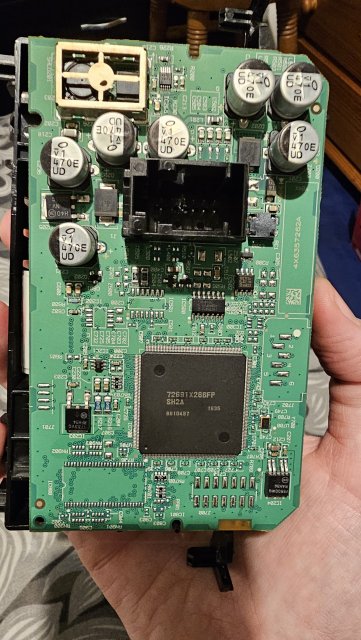

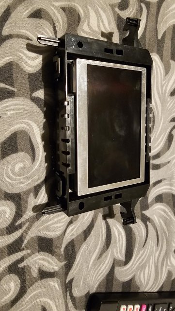

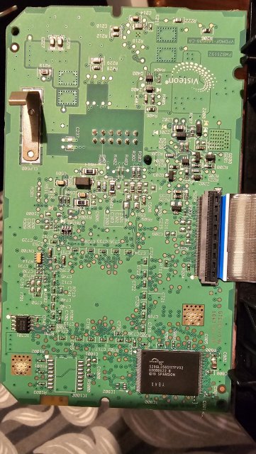

Inside of my old module behind the screen
Nothing looks blown that I can see. 🤔
Was it *just* the LCD + digitizer that was replaced or were the logic and power supply board(s) included? I don't know which technology that display is, but the old LCD panel technology have tiny CCFL tubes driven by an inverter. Sometimes the tubes would burn out or/and the inverter would fail. In old designs the inverter boards used to be so much more prone to failure that they would be their own separate PCB. Eventually reliability improved and they started placing on the same PCB. Cheaper, more power efficient and reliable, the backlights are LED driven now. Only reason it took so long for displays to convert over to LED backlight is their color output was skewed.

I'm not very knowledgeable.
It was a new screen with the black module thing with motherboard inside, purchased 2nd hand from a breakers yard on ebay.
I just took out the old one and put that one in its place, put the wire in the back to get power and screwed it down and turned car on and thankfully radio came to life.

Okay sounds like the whole kit & kaboodle then. When just the backlight goes, sometimes you can see a faint image on the display.
