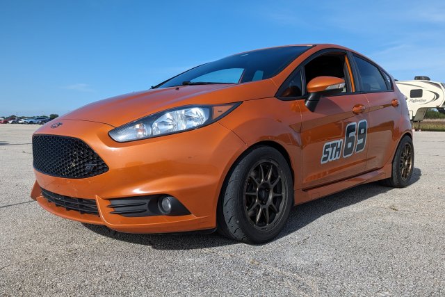

I'm running the 15x8" +35 TD pro race LT currently for autox/track with a 10mm spacer up front to clear the coilover, and -3.5° camber. About as pokey as you can get on the stock fender but I still think it looks pretty good. Front tires are 245-40-15 rt660s which are already more of a typical 255 width, handled great at a national autocross but the additional torque steer is definitely noticeable on the street.
hawyee
Active Duty U.S. Air Force
117
200
OKC
Fenders aren't rolled or pulled, the main problem area is the fender/bumper joint but only rubs there on huge dips. Lowered about an inch from stock, ground to fender measurement with these wheels is 23.5" ish
