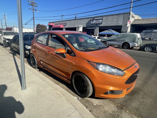

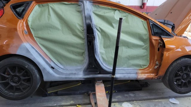

Annyways…..Guess who’s back…. Ok not sure why two images posted four times but ya not gonna worry she looks great and still drives great!
She will definitely hold me over till I get my GRC then she will go to back up duty and weekend fun. Ya not gonna get rid of her but definitely would not mind a new daily.

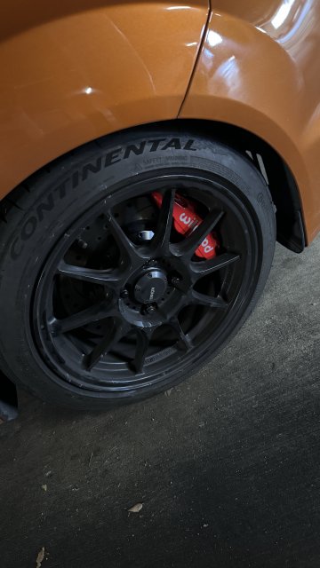

Oh Oh what do we have here a little update with SuperPro controls arms ( sorry guys no pics of them yet, did not stop to take them will come after alignment is done) and Wilwood 6 piston Calipers with biggere drilled and slotted Rotors . Why you ask , 1. They clear 16 inch Dekagrams without Spacers! 2. I got them in a package deal and decided why not try them out.
So out with the Whoosh which required 3mm spacers at least and in with these!
IMG_1022.jpeg IMG_1021.jpeg On and Continental Contact Extreme Sport 02 tires 205/45 for the winter as they rate real high in wet road situations. They are basically an upgrade DW 06 All season to the point they even still have DW stamped into the tread!

I did not do the rears. I have not really fully bedded the brakes in yet . I Basically got them in and we did a partial bedding and then I had things to do. So i have not really taken it out and driven it hard initial impressions is they do not seem out of balance to my rears which are EBC USR rotors with Yellows.
I did not notice these grab fast a little more pedal travel but a fast bite that can pull you down from any kind of speed very quickly. We were talking about the actual Caliper design and the basic Caliper design of the Whoosh is better than the Wilwood . Though the Wilwood has more surface area with 6 piston design and larger rotor. The surface area of the Whoosh is identical to stock but with a bigger than stock rotor. Oh and my Wilwoods are even lighter than the Whoosh.
Whether one pays full price for the Whoosh or Wilwood also comes into play here as I got hooked up from a friend on the Whoosh originally and like I said earlier the Wilwoods came in a package of parts with a car I purchased. It was a no brainer to try them out.

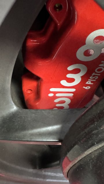

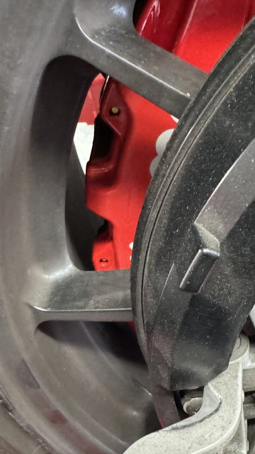

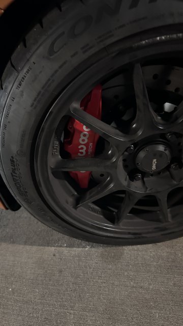

took a couple of quick photos of just how much clearance the Wilwoods have today during my wheel alignment 3.8 positive caster, 2.3 negative camber close to if not 0 toe and the front end turns in like a champion! The second phot is better at showing off the barrel clearance on the rim there’s over an inch it makes me wonder if these would fit under 15’s . Oh and spoke clearance with the Dekagrams is close to an inch ( close up kinda distorts that second pic is better) IMG_1063.jpeg IMG_1062.jpeg

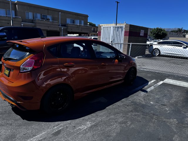

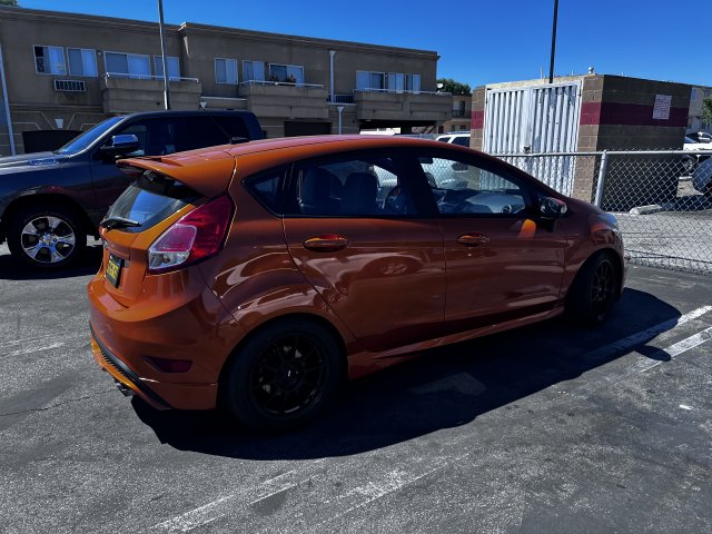

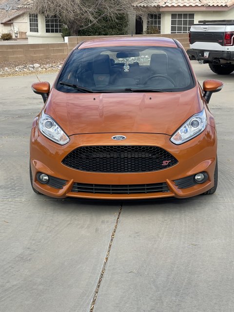

Since Dave (Dpro) decided to cross over to the dark side (GR Corolla) and sold me this FiST, decided I would continue to detail its continued evolution, lots of great info from Dave In the thread. First change: new plate, Wicked Pumpkin (WKDPMKN). Next thing I did after buying the car was to install the Euro OEM projector housings which Dave had sold me. Very nice upgrade over the US factory housings; currently experimenting with different light sources. Funny how delighted I am with the DRL’s since I’d never admired them on any other car until I installed these on the FiST and suddenly mine struck me as “cool”, lol. Next up: swap out the EBC USR rear rotors for new 280 mm SVT Focus rotors that I had sitting in my garage for years (previously had 3 SVT Focuses, all met sad endings, missed them, led me to the FiST). Just got the new caliper brackets from Whoosh. EBC USR rotors will join the upgraded fronts that Dave had removed when he decided to try the Wildwoods (which he generously gave to me) and will be installed on my “stockish” other FiST.
