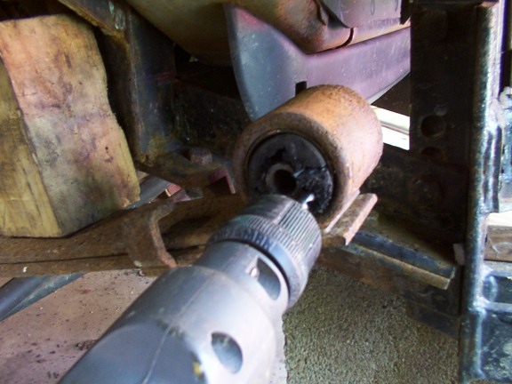

Looks like $86 for engine mount bushings. I wonder how hard the "press old bushing out" step is....

There are old school ways to get around it if you're having issues. I don't necessarily recommend doing this just because it's a bit sketchy for me, but you can always burn out the old bushing, just set it on fire and let the old bushing melt out. For obvious reasons this isn't really a good way of doing it, it's messy, smelly and can be really dangerous (you're setting fire to rubber.... I mean comon, haha). Alternatively you can drill holes into the surrounding part of the bushing to give it more flex so you can push it out easier, like this:
Once again this step can be dangerous, and is a bit sketchy, but these are old school ways that have been used to help out if you're ever having a huge issue.

You can usually go to a machine or brake shop with a bearing press and they will charge you about $12.00 per bushing to push them out. Thats usually what I do.
