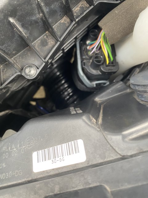

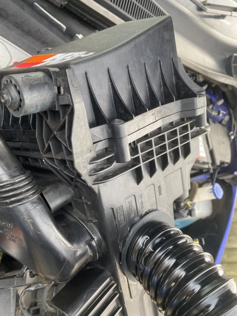

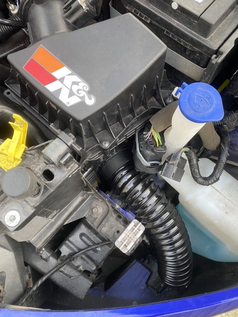

Best way to increase the sound whilst retaining cold intake temperatures is to drill a 2.5’ hole in the side of the air box and route a 60mm ram air duct underneath the headlight. See images below E393D7BA-0609-452C-9681-201DC7405148.jpeg E393D7BA-0609-452C-9681-201DC7405148.jpeg 3B59256F-1EE2-47E3-A5D0-5105139EC8B3.jpeg E393D7BA-0609-452C-9681-201DC7405148.jpeg 3B59256F-1EE2-47E3-A5D0-5105139EC8B3.jpeg
I haven't seen much on the 2.5 inlet that you have on the air box, do you have a part number or something (Amazon, ebay, etc?). Did you cut a hole in your bumper under the headlight, like AET Motorsports does with the ITG kit?
