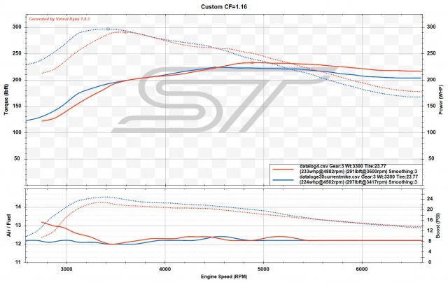

Another map update looks like Brian added more boost but took away a few degrees of timing, kinda of a wash because i didn’t really do much other than make the numbers lower however butt dyno it pulls harder so go figure
Gogoggansgo
#11105
160
142
Thread Starter #25
he added more boost enriched the afr to 12.2 instead of 12.5 but took away some spark advance under the curve interesting

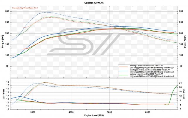

Thread Starter #26
Be aware i has to rush these v dynos so a few aren’t right and i forgot to add his wheel and tire combo
basically it’s a wash

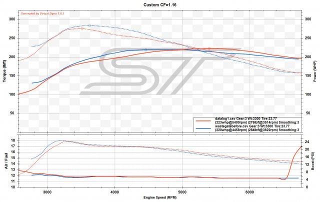

well here is a direct before and after with the wastegate on the final tuning brian is very happy with the results. but there is a few caviats
1) the 93 before log had a gallon or so of corn in the tank and that did help out the midrange otherwise they would be on top of each other
2) the big gains are on corn like wow and we are also looking at e40 right now for testing
the finals numbers are 10-15whp above the stock wastegate and the power curve is much more linear

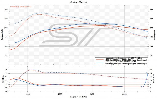

anyways got some more updates Brian is adding more boost here is before and after
