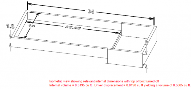

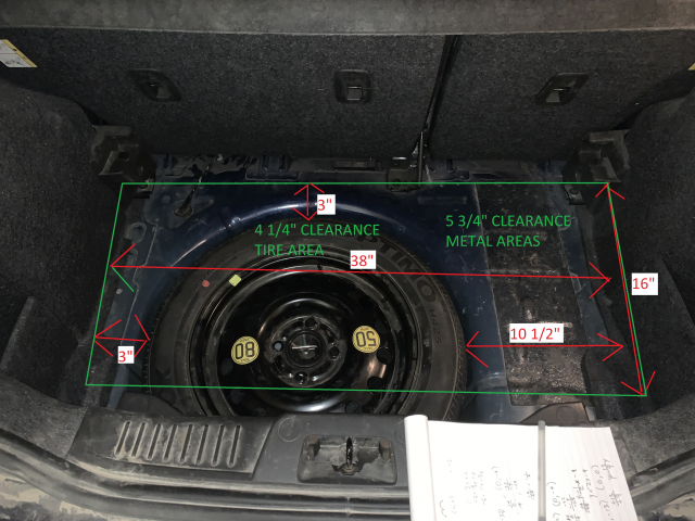

I am designing a sub enclosure that I think will possibly fit under the rear floor. For components:
Audio control LC2i pulling from front speaker(s) (thinking about turning off sony processing, but if I do not less distortion on the fronts)
JL Audio 10TW3-D4
JL Audio XD 600/1v2

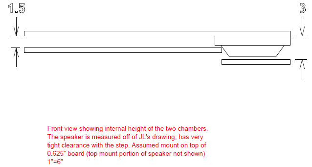

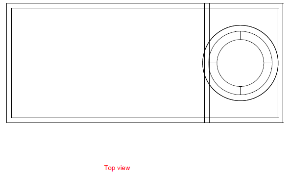

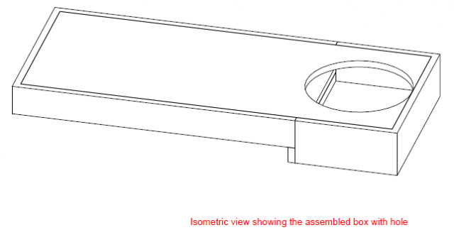

Below are some sketches I made along with my measurements of available space. Assuming .625" thick material, 1/4" from inside floor to bottom of speaker, top mounted with no recess into the top board.
Do you all think this is feasible? I am a novice in this sort of thing.

It will work. Take a look at what this forum member did not too long ago:
https://www.fiestastforum.com/threads/diy-stealth-box-system.21624/
While I see the appeal, I just don't think it will sound as good as a down facing shallow mount box or even a 6 1/2" Bazooka tube; both of which don't take up much room and can be relocated in a matter of seconds.
