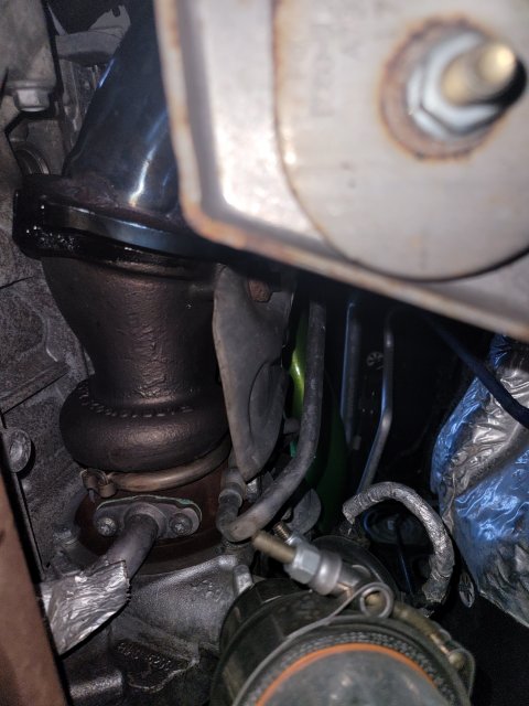

So, new turbo is in... still have issues. new issue is the turbo seems to be spooling at idle? Put the base tune on there and car is revving itself to like 1300 rpm can hear the turbo. Secondly, pretty sure I was originally dumping fuel out the exhaust not oil... now i'm at a loss. gonna tow it to a shop but figured we could speculate

When you say base tune, you mean the tune for the new turbo, right?
Mine did the same, turns out the PCV line was disconnected and I was sucking in a ton of excess air.
