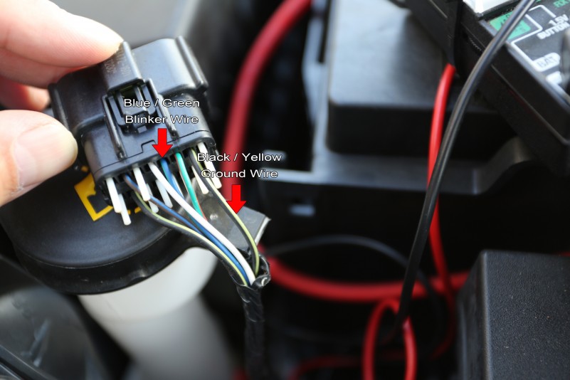

Shouldn't the pin outs be the same, regardless of the color of the wire going into the connector. Look for a mark on the connector showing the #1 pin and count from there, then second row. Should be the same pin out position on the left and right sides.

Well stupid ford.... The passenger side colors are different.
Ever figure out what the colors were for the passenger side?
