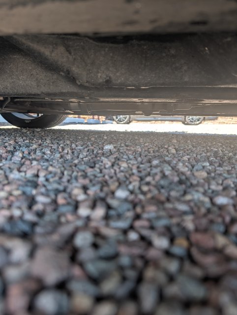

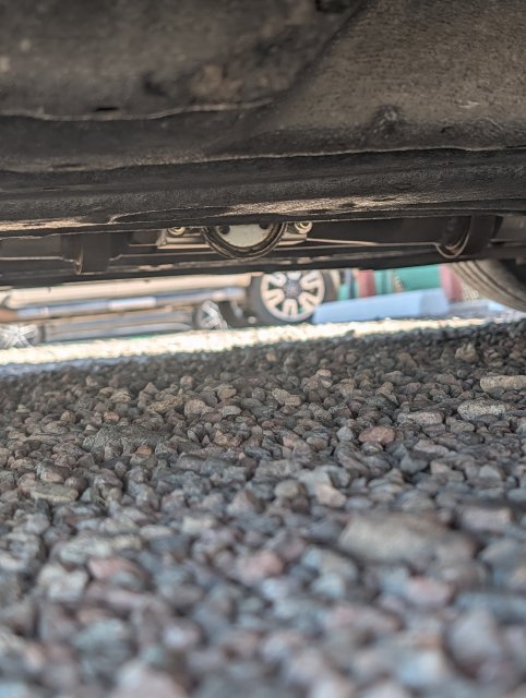

I used this, and I had a local shop replace the factory resonator with it. I had them add V bands incase I wanted to change the sound... I absolutely love it

I used a local shop to weld it up and I think they charged me like $80, but it maybe took like 40min to route all the wiring and powered... I do recommend v bands so you can clock the dump properly like I had too, the welding place originally had the motor sitting at the 5 o'clock position and that was too close to the ground
