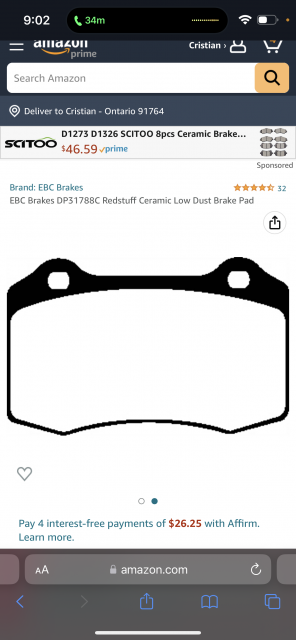

Just an update. I installed EBC red stuff pads. I found out the Tarox pads for a B30 kit is the same as the rear pads off a 2010 Camaro 6.2L. It’s also found one some other Chevys and Jeeps. I just had to remove the brake wear indicator with some pliers and slapped them on. Brakes are now whisper quiet. DP31788C is the part number for EBC red. I’m also sure Yellow stuff is available and all the other colors.
