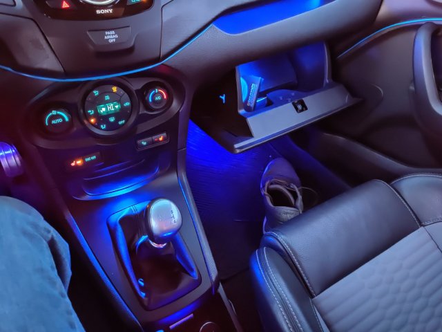

Saw a member do this so I followed suit. When you add the LED light bar that older models of FiST's came with you're left with 2 extra LEDs when you get the harness. I did this a year or so ago and just have the extra LEDs dangling in the glove box. The two extras are technically for the footwell but since you already have footwell LEDs you can't use them. I decided to do what a member did and put one in the cubby hole and the other in the glove box.

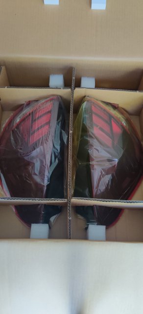

In other news I ordered the Osram LED tail lights from Germany. Claims it'll be here May 28th-June 4th. We'll see how accurate that is. Also ordered 4 OEM tail light harnesses part#: D2BZ-13K371-A so I can make a harness for them to work. Not too difficult. The Euro Osram tails have a female connector on them compared to the US spec male connector. Just need to wire 2 OEM harnesses together on each side and they work perfectly.
