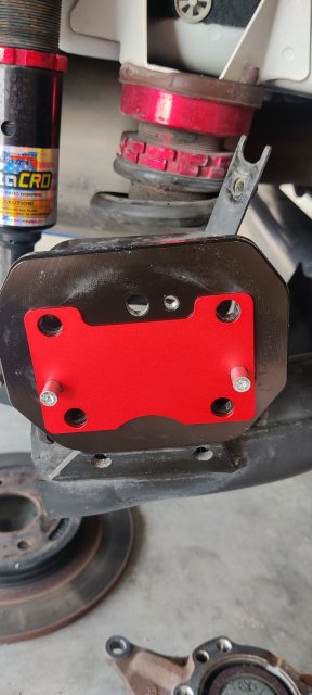

Haven't done much. I got the itch to do something to it as the last mod I did was the BA intercooler two years ago.
Put on some Whoosh rear camber plates so that the rear can match the front. The front currently sits at -2.1~ and this looks pretty damn close to it. It's funny, the RR hub basically fell off after taking everything off. The guide pins looked brand new for the hub. The LR however required some persuasion and the guide pins were seized on the hub, odd. Nonetheless really easy to do and if I don't like it I'll revert back it's so easy.
This car will most likely stay like this as I'm trying to save for my wedding and potentially a house. This car isn't going anywhere as it's paid off and I love it too much so don't worry about that.

The whoosh plate adds 1.5deg of negative camber. Is this enough to adversely affect the tire wear if mainly driven on the street?
This question could extend to the front as well.
Have we established a maximum ''daily'' camber that can be safely run without impacting the wear of the tires?
I can speak on that too much because I haven't had them that long but I also have a second set of wheels/tires for winter. So one set isn't used 100% all the time. with only 1.5 degrees you should be fine, thats really not that aggressive
Around 3 is when you'll really start seeing some quicker inner shoulder wear on the street.
