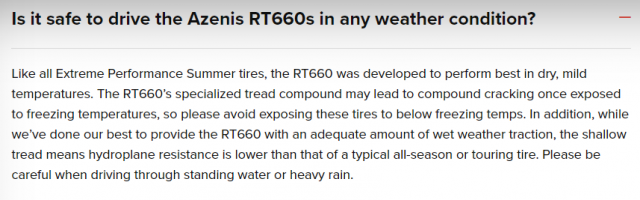

Falken recommends that you don't expose them to freezing temps.
It was 36° when I left for the event on Sunday, but I had been garage parked over night, didn't die. YMMV
edit: added screen grab

That screen grab you posted was interesting, where is that from? Here in North Carolina it doesn't snow enough to justify getting winter tires. The few times it does snow I just stay off the road, so what I do is get summer tires and use them year round, I just drive them carefully when it gets below about 45. Clearly the RT660 would not work for me as a year-round tire. I have gone through a couple winters here with the OEM Potenza RE050As, and a couple more with the Firehawk Indy 500s that I replaced them with with no problems with the tires cracking from the cold.

I just got it from Falken's RT660 page: https://www.falkentire.com/azenis/r...cHyxsbXWXlApZ2k2oJcm5nY5dR9ZcArRoCxA4QAvD_BwE

You can look in your owner's manual for a discussion of how summer tires are to be handled in cold weather. The OEM Bridgestones have the same warning. The tread cracking happens when the cold tire is forced to flex. This happens below 32 degrees F. In fact, it's at 20 degrees, as Tire Rack says. IF they are exposed to temperatures that low, you can't just wait until it's above 20 degrees to start driving. They have to be warmed up more, above 40 degrees first to decrystallize the compounds in the tread rubber.
That said, there will be temperatures below which traction will suffer, even though the tread is not in danger of cracking. Look at the trouble Formula 1 has had in their early, cold temperature races.

Thanks for the heads up, I will look at that.

lol. I mean, first race of the season, car was parked outside in 15F weather, drove 90 min to pittsburgh in 15-20F weather, warmed up to 40-50 for the day, and I got 6 runs in at the warmer temps. That was a few weeks back and my tires are fine.
