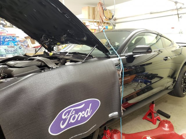

The Mustang is up on jackstands and the Whipple plus TSS oil pump, timing chain, gears begins in the A.M!
Gonna be an awesome daily. I really miss having a v8 and pd blower. Especially when paired with some drag radials for the streets it was alot of fun.

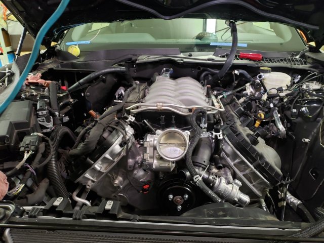

I got hung up on a few items, like the bolt that secured the guard on the HPFP to the head snapped it's mount bolt. Thank goodness the bolt goes fwd to aft through the head and threads into the back of the guard. I had to cut the bolt and drill the broken section of bolt out. I've stopped working on it at the point of just pulling the harmonic balancer. I'll resume in the morning. Hopefully, I'll have the oil pump gears, oil pan reinstalled, timing chains reinstalled and harmonic balancer reinstalled tomorrow. If not, no big, I don't have to go back to work until July the 10th.

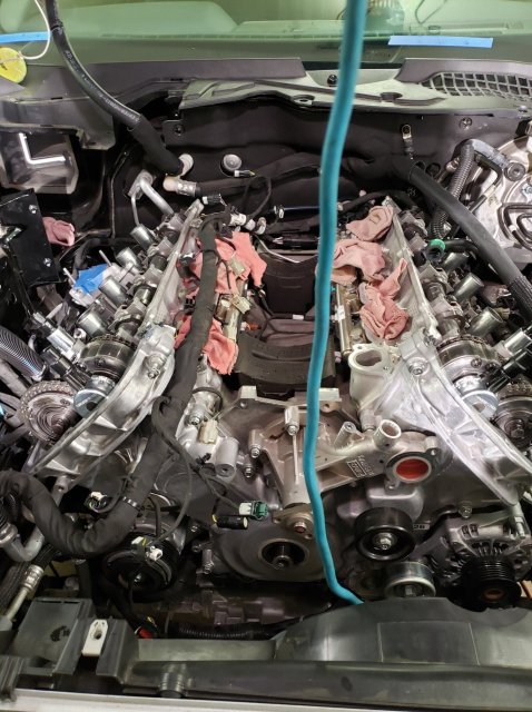

Thread Starter #54
More progress. The harmonic balancer was a pain. Time for a break, I'm cooking ribs toninite and I've gotta get the grill going and run some errands.

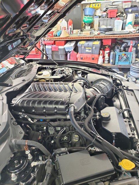

25 or so leisurely man hours (solo) I've completed the oil pump gears and cam chain sprocket installation. The supercharger is in, but the kit was missing two pulleys. Whipple has great customer service, they shipped the pulleys out today and I'll get them tomorrow. All that's left is mounting the two pulleys, installing the belt's and installing the LTR (low temp radiator), adding 10 quarts of oil, oil filter and a double check of the installation. There is light at the end of the tunnel!!

As a matter of fact, I got the majority of parts for my Mustang from Terry. I'm going to run the canned tune. I'm not looking at winning any horsepower contests. I had to resort to doing dyno pulls to datalog for my Fiesta, since I had to use 4th gear so the tires wouldn't spin. Third gear, the tires started to spin up top. With the Mustang, there is no way, that I want to do pulls on the street. Also, since I've sunk 15K into this car in aftermarket parts, I don't really want to spend another grand for a tuning tool, tune and dyno pulls.
