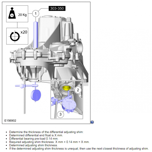

according to the Ford manual, yes, it would go underneath. (i.e. goes into the case half before the race)

Yeah I found the Factory Service Manual a few minutes ago. Looks like we need .14mm of bearing preload.
You mentioned that during all of your install you did not need to shim the races, how did you determine that if there was no end float? I feel like you could figure out that end float = 0mm but you wouldn't be able to determine the positive preload because the diff would be tight with the transmission assembled?

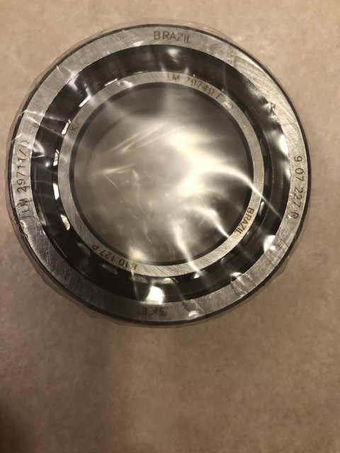

Also, does anybody have an LSD installation kit on hand and can take photos of the bearing part numbers?
Ford got smart and started removing the bearing boxes before shipping them. The first one we did had the boxes and I shouldve taken a picture. The OE number is 96WZ-4220-A
Yeah, unfortunately that part number leads to the equivalent NSK bearing. SKF is the old supplier I guess and are superior bearings. I have an email out to SKF to see if LM29749/Q is the same as LM29749VP.
I was going by the word of the transmission builder who I asked beforehand. He looked at it and said it didn't need them. Like I said though none of these gearboxes make any noise, all work just fine.

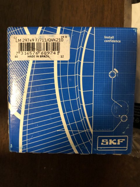

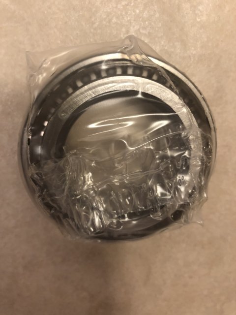

I have the Ford Performance LSD install kit (waiting for installation). Does this help?

Can you also take a photo of the stamp on the bearing and race itself? Is the cage plastic?
It's hard to get good pictures of it still in the packaging -- but here's an attempt.
The cage appears to be brown plastic. IMG_2760.jpg IMG_2761.jpg IMG_2761.jpg
The cage appears to be brown plastic. View attachment 27824 View attachment 27825 View attachment 27825
I appreciate it! Thank You! I contacted SKF and they confirmed that LM29749VP (Bearing) and LM29711VP (Race) can be interchanged with the above if you want a metal cage instead of the plastic. Both are available on RockAuto for super cheap.
I’ll show my ignorance:
Is a metal cage necessarily better? What is the benefit? Is there a downside to metal?

Biggest concern for me was that SKF rates the plastic cage to 160F which seemed a bit low for the transmission. The bearings in my tranny have metal cages and I want to keep metal cages on the new LSD bearings. That was pretty much the extent of my thinking. I am not sure why Ford includes the plastic units in the LSD install kits. I would assume cost but there may be a real design reason for it. I am choosing to ignore that choice LOL
