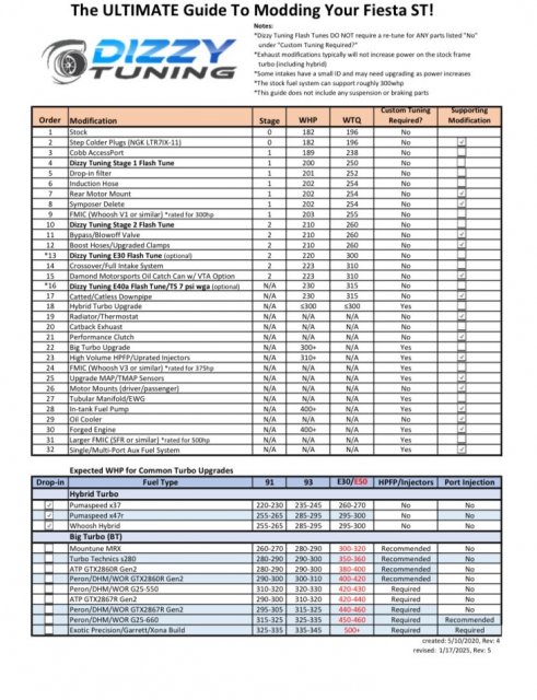

I threw this guide together for the community. This can be considered a step-by-step guide on how to modify your Fiesta ST. It has been compiled from all the data and knowledge I have learned from tuning various Fiesta setups over the last 3 years. I am open to suggestions, and will keep the latest version posted at the top of the page.
My suggestion to some of you, is to find the modification that is currently installed on your car (with the highest number to left of it). Once you locate that line, you should have every modification listed above it, already installed on your vehicle. If you do not, it is highly recommended.
