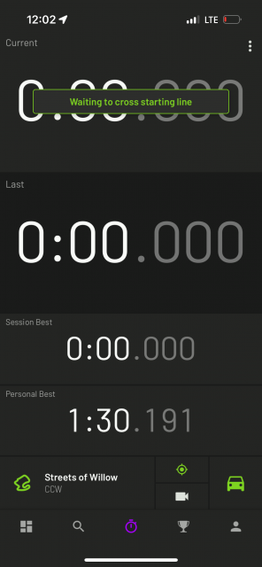

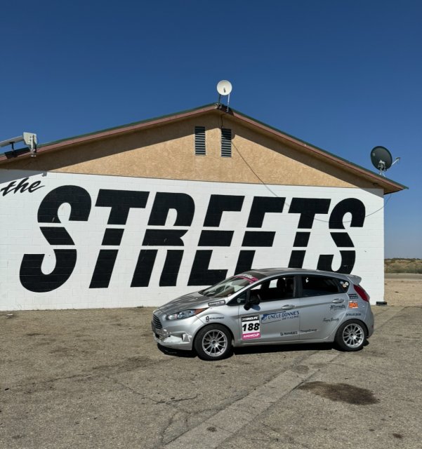

Finally had my first track day on my new Eibach rear sway bar and my continental extreme contact force tires last night. It was a night event at streets of willow that went from 5pm to midnight.
I was instructing this event. So thankful I was able to go out in any session. I wanted to put these endurance focused tires to the test. I went out for 5 sessions IN A ROW to test these out. Thats 1hr and 40 mins of driving. With only a stop in the hot pits in between each sessions to start again in the next session. The tires never felt greasy even in 90-106 degree weather and I was doing 1.33-1.35 pace depending on traffic at this time of the early night.
after I did that 5 session stint I stopped driving for a bit to get some food and some rest because I basically did a mini endurance race and my forearms were burning lol.
after that I gave some more ride alongs and instruction for others and I went for a PB attempt around 11:30 at night since the weather was finally favorable. And I finished the night with a new PB of 1.30.1
I think the biggest contribution to the PB was the rear sway bar. The amount of rotation you can achieve with oem shocks and some good trail braking on this setup is amazing now and it’s so rewarding to use. The car went from and understeer/ neutral setup to a now neutral with slight oversteer setup. Ideally I would still want more oversteer but this is a very big improvement over previous.

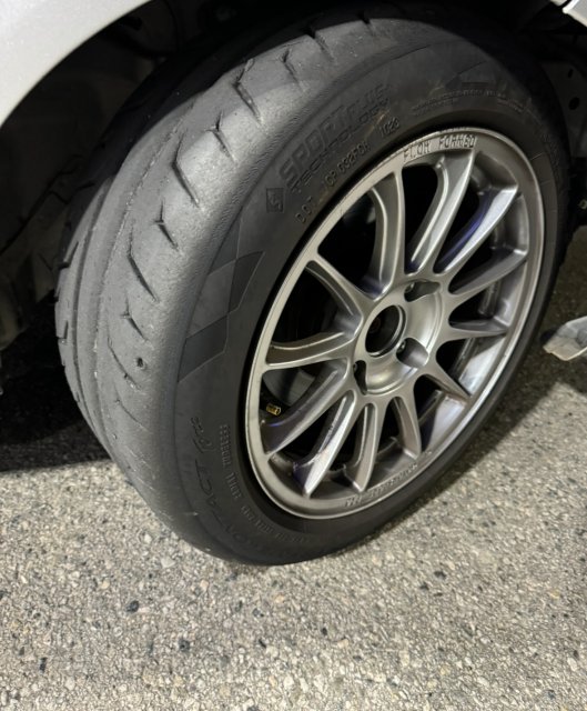

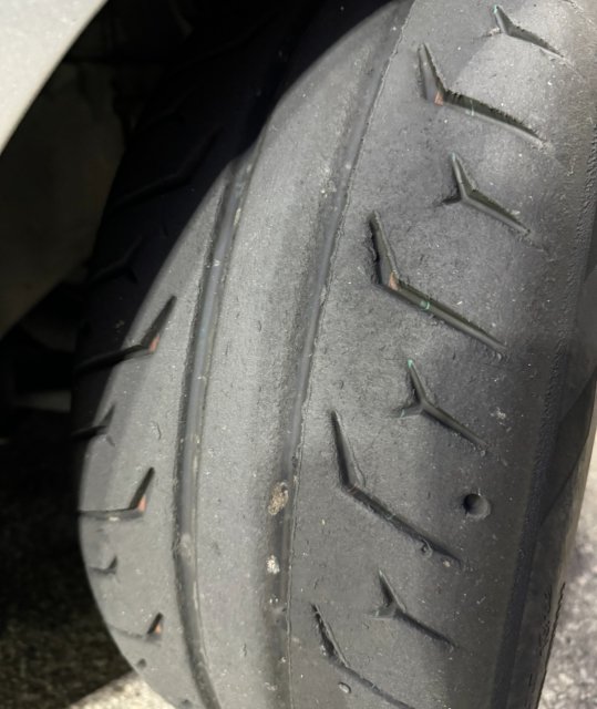

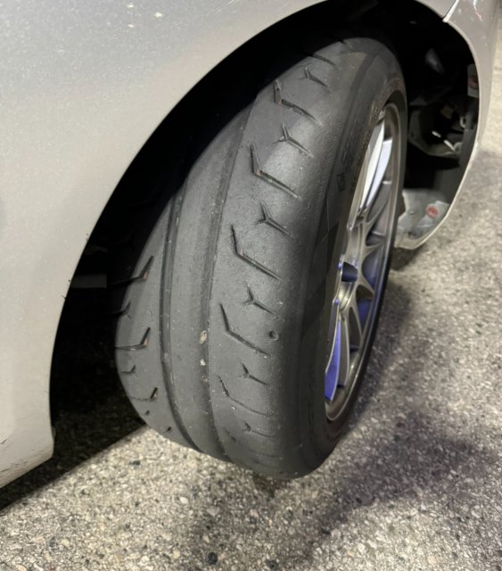

my continentals did great all night long. I did a total of 12 sessions and each sessions was around 15-20 mins long. I went out three times for 2 laps to test pressure changes but I am not counting those in the 12 sessions I did.
12 sessions is equal to about 2-3 tracks days for most people depending on the organization and driver. These tires look like they went through one light track day. My RT660 would look worse after a single competition day.
im really excited to see how long this tire lasts me. It is already looking favorable in the wear department.
while these tires did achieve me a 1.30 on streets ccw. I still think the biggest contribution to that was my sway bar and not the tires. However the tires were very consistent and predictable. Even with loads of heat all day and constant abuse and try new driving and pressures I felt prettt confident in what the tire was going to do. I think the confidence from the tire and the sway bar is mostly what got me that PB. My biggest complaint with the tire is that the turn in feels lazy and not quite as sharp.
most 200tw will have a nice crisp turn in if you have a good stretch on it and this tire setup (205 tire on an 8” wheel) felt more like a 225 on an 8”
the tire still felt plenty grippy. But compared to the RT660 I would say the falkens have a much crispier turn in. And if you ball out on AO52 or RE71RS that turn in would get even better.
the tire is also VERY communicative on grip levels. I’m not sure how to put it into words. But the tire makes different types of “screeches” depending on what you are doing with the car. For example the tire makes a different sound if you overwork it on entry vs exit. It was very interesting and also increased confidence. Some people like loud tires others don’t. I think it’s a good tool for beginners.
overall this tire is looking promising for me and my only complaint is the slightly worse turn in and about a second or so pace behind an RT660.
(I used the RT660 as a reference because I have driven on 3 sets of them now on this car with the same size combo so it is my best comparison to make)

TLDR;
- New streets of willow CCW PB 1.30.1
- rear sway bar added good rotation. I still want more rotation
- ECF tires have lazier turn in that other 200tw.
- ECF tires handled wear in 12 sessions on track better than RT660 in 5-6 sessions
- ECF tires very consistent and didn’t get greasy like most 200tw would.
