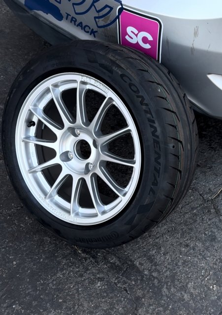

You painted the Motegis?
(I know that you are waiting on your KE Motorsport Pro T12s.)
No they are heavily coated in brake dust right now haha. Haven’t had a chance to wash the car. Up close the car still has layers of bugs from my trip to Laguna Seca too. It’s really bad. Everything besides the interior is a mess.

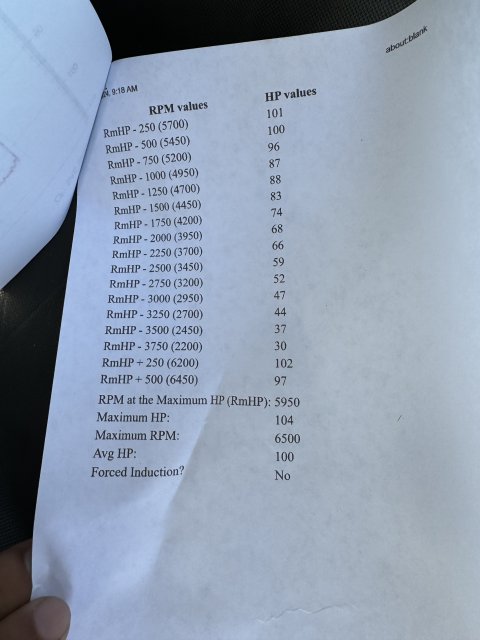

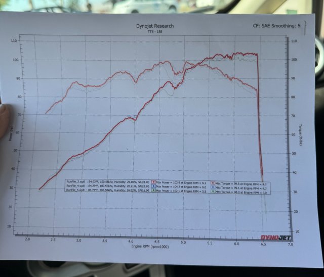

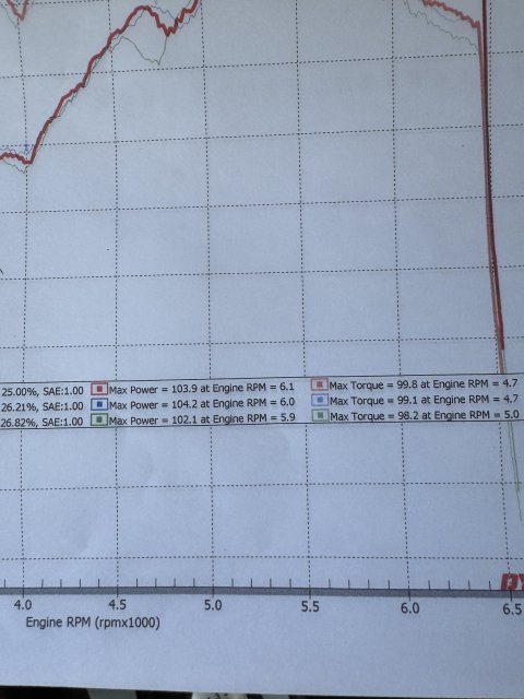

So I’m told from other time trial competitors that the mobile dyno reads high.
im not sure how accurate or not that is. One of the competitors says his car was 30hp more here vs his tuners dyno.
But I ended up with 104 whp and 99tq as me peak figures. My average horsepower is 100hp which is what nasa uses to class me. This means I could technically strip my car down to 1900 pounds and it would still be class legal.
don’t think that’ll happen anytime soon. But these numbers are nice to know.
my biggest take away from this chart is to basically keep the car over 4-4.5k at all times. Anything under is brutally slow.

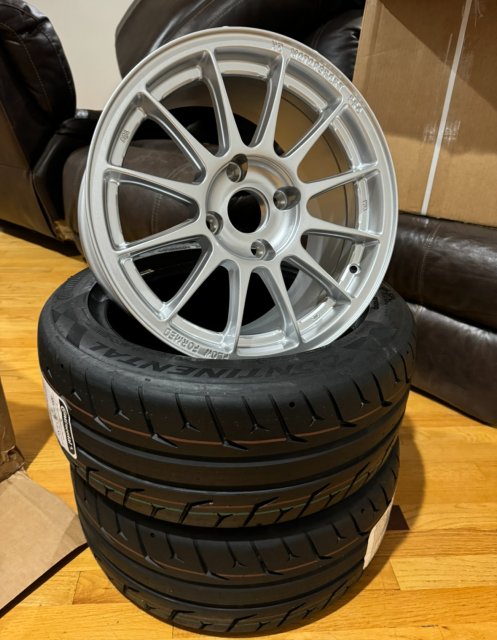

^^^ I may have seen your boxed wheels sitting there in Phil's warehouse when I was there last week picking up my Pro T12s and getting the AD09s installed on them.
I was considering the silver, but decided it was too bright a silver for me (I prefer a more anthracite/gun metal color), so I went with the 'rally satin black'.
Given how much everyone complains about how much dust the Motorcraft factory 'summer' S pads I will be installing in the next week or so produce, even on the street, probably a better choice for me.
We hope to see some new personal, and even class track records with your new setup above, soon! [wink] [twothumb]

I feel you on the brake dust. P21s wheel cleaner makes it a hassle free affair to clean them at least.

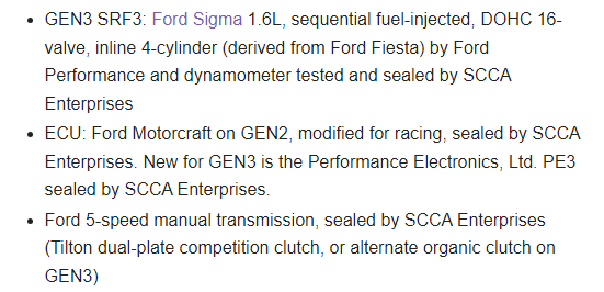

Just made an interesting find on my lunch break. I was looking into cheap wheel to wheel classes to compete in. I was looking into some details of the current gen 3 spec racer ford series in SCCA since it appears to be very popular here in CA. and it looks like they run some variation of my base model engine.
Lots of people reporting very high reliability on these engines. Lots of people on multiple competition seasons on the same engine. Makes me feel better about the reliability of mine even if they have variables. I'll be doing more research to see what kind of info I can find on this. I'll report back any interesting findings. or if anyone has any interesting/useful info I would love to hear it.
some links I briefly read:
https://www.apexspeed.com/forums/showthread.php?79350-SRF3-operational-costs
https://en.wikipedia.org/wiki/Ford_Sigma_engine
https://en.wikipedia.org/wiki/Spec_Racer_Ford
