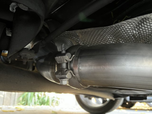

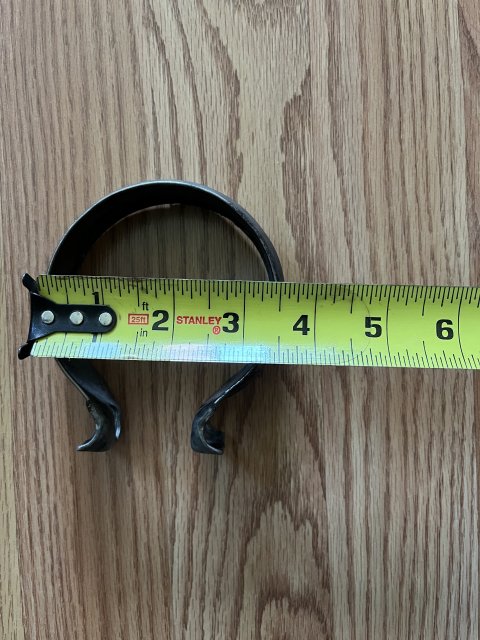

I can’t see how this clamp could be bolted on the spherical clamp. 3B6A98E7-5660-4958-9CD4-06B39E9EB055.jpeg
Is it the wrong size? The pipe is 3 inches, but the bulge at the spherical joint increases the diameter. 289EBAF3-39EA-4146-922A-B153A7322529.jpeg
I’m gonna see if local muffler shops have a larger diameter spherical clamp.

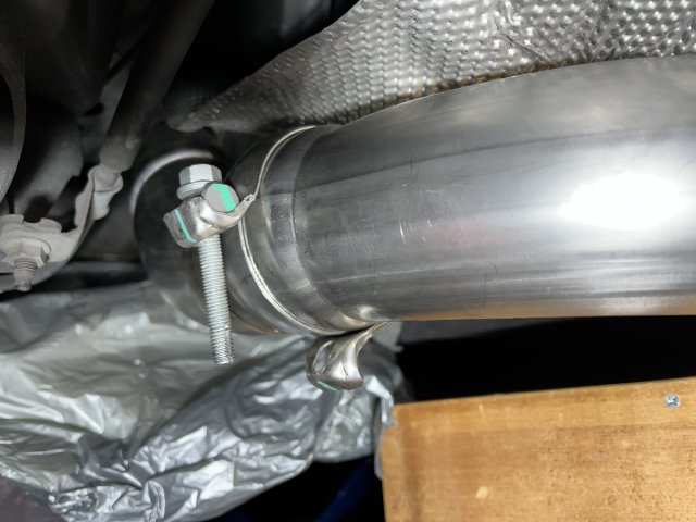

Lucky for me, a local muffler shop had a 3.5 inch clamp in their used D0059AC2-2E0A-4310-894C-B8D84459334E.jpeg 9B1FDF6D-450D-4A13-BFBF-3C0E8A57F991.jpeg parts bin. It works, gets kinda close, but still plenty of gap and it’s effective.

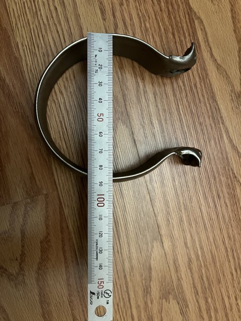

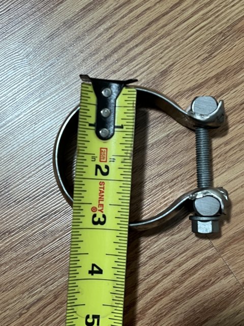

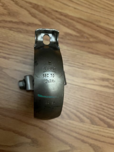

Thermal sent me the correct clamp. It is a Norma SEC 70. 70 mm nominal diameter (with bolt on). Shame on me for not doing a fit check before I cut the oem exhaust. Hope other people can use this for reference.
I used this for a reference, but only after I had cut out my exhaust as well... I actually found something at NAPA that is getting me by for now, but its clearly not the right clamp, new clamp will be here Monday...
