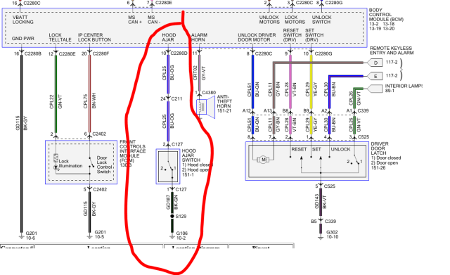

I'm sure a few of you have experienced this issue, where the hood ajar warning chimes with the hood latched securely. I work on electronics for a living so I verified continuity (switch is fine) and a jumper just to test...
NADA
The error is still present😮‍💨. I removed power and then crossed leads to discharge any capacitors without any success. My next step I guess is a new battery but I don't seen to have any other battery related issues..
Somebody just tell me I won't need a BCM, those things are expensive😤

Did you test continuity for the entire circuit? Where does it terminate?
I haven't found a schematic that shows it's trace yet, it disappears into the loom...
Maybe I'll spend the time this weekend and open the loom 🤷🏼‍♂️
sczamun
U.S. Air Force Veteran
65
37
Indianapolis
Im new to the ST, but Id assume there's a plug that goes to whatever module. Probably don't need to open up the loom. I'd try to find that schematic of I were you
