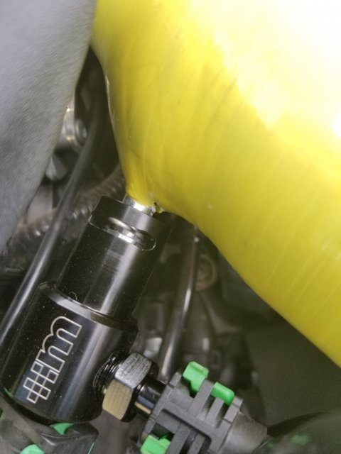

Anybody else have an experience with a tear on their silicone induction hose? Just installed a couple weeks back and when I went to install my OCC I noticed there was a hole near where the evap line connects.
Albeit a small tear I went back to stock while I contact regarding maybe an exchange, just find it a bit odd if this is a design flaw in the hose maybe?
My theory is the evap system was putting too much pressure on the hose connection and thus that's why it occurred. The hose sits just as the stock one does which sucks that this happened.
Just ordered the woosh crossover pipe and about ready to buy the ST200 intake but guess my intake noises will have to wait a bit 😭.

I have the same piece. No issues.
Probably just a bad one. You don't hear about these failing much.
Don't let them cheap out and replace just the little jigger, or the hose. Replace the unit as one piece.
If you have a preferred color, get that. They owe you.

When you installed yours did you feel like the evap harness was pushing back against the induction hose? I tried to orient it many ways but no matter what there was always some slight pressure against it. Same with the OEM induction hose but that one is a lot more sturdy where the connections are made.

Mine felt exactly like stock. Had it on perfect in minutes. There's some defect in yours, and they should send you a complete new one, pronto.
If they want the old one back, they pay to ship it.
It's called quality control.

My Mountune intake hose has a similar issue. I only noticed the issue recently through. I've had this intake hose for about 3 years now. Mine didn't tear like yours but when I flex the aluminum vacuum tube around you can clearly see it isn't bonded to the silicone hose anymore, plus it's worn a hole on the inside of the intake hose. I used some Gorilla glue to bond the vacuum tube and the silicon hose together to seal it up for the time being until my replacement intake hose arrives.
I ordered a Peron intake hose which is similar to the Whoosh intake hose, both of which appear to have a better design for that vacuum connection.
If it's a common issue then gorilla glue may be my next option. Does it hold up to the heat of the engine bay OK?

I just applied it last week, seems to be doing ok so far. I tried superglue 2 moths ago when I first noticed it but it didn't hold up.
