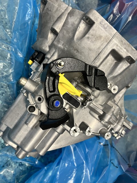

New transmission picked up today. 4.3 final drive kit comes tomorrow. I need to pull the old trans this weekend, and everything to the shop on Monday for install of the 4.3 and swap of the Wavetrac.
If anyone is considering a new OEM, it comes with axle seals and a new slave.

Is it actually new? I don't understand why Ferd wants your old transmission back if they are selling you a completely new unit.
Please ask your installer to take pics of the inside of the "new" transmission.

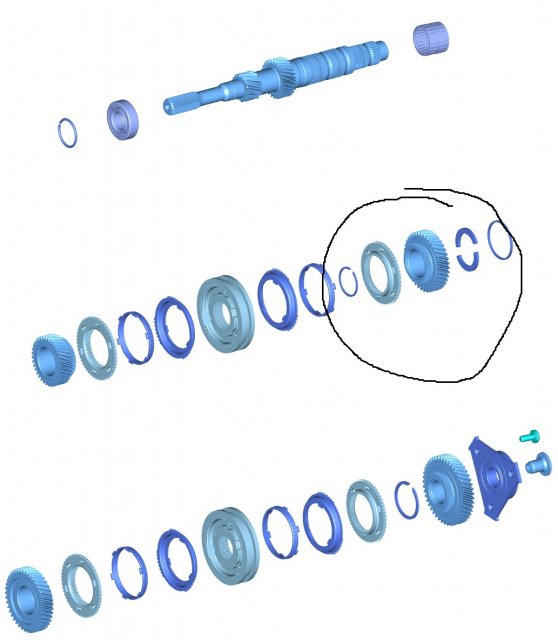

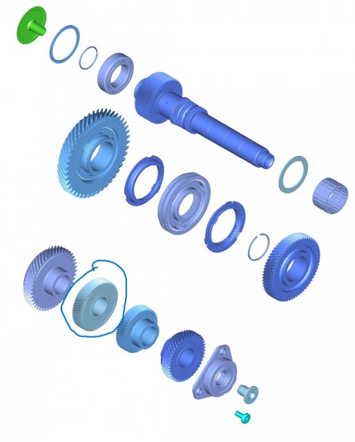

BTW, if you follow the Ford Manual, you will need a new 3rd gear when changing to the 4.3 final as you have to cut the 3rd gear off the counter shaft. If you chose not to cut it off, it will take a 50ton press to shear the snap ring that holds that gear stack together on the shaft. (learned it the hard way)

Yes, it’s new (not remanufactured). I assume they have a core because they repurpose the case.
I’ll def ask for the pictures.

Transmission from Ford is brand new. Not a reman part number from Motorcraft. Ford takes the core back to rebuild in future under the Motorcraft remanufactured line.
Ford OE - C1BZ-7002-C and is the final iteration of the IB6 transmission(C). The C1BZ-7002-B was updated sometime in the 2017 model year. No idea on the updates performed.
Motorcraft Remanufactured is not yet available per the parts database. I assume they will start rebuilding cores soon enough and issue a part number.

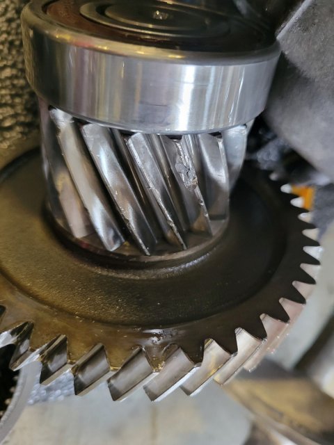

And the carnage. Without being able to know for sure, the theory is that a 4th gear tooth gave up the ghost and took out the rest.
Would make sense, given I was in 4th and it suddenly felt like I went to neutral. 3rd grabbed for a bit, and then it felt like neutral. Then, the crunchy noises …

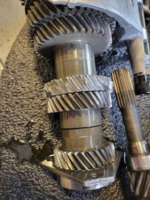

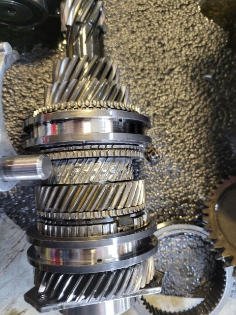

FWIW, if im looking at this correctly, 4th gear is the chewed up gears on the main/counter shafts.
https://www.fordpartsgiant.com/part...el=&extra1=&extra2=&filter=(6201;13221;13480)
With both the old and new units cracked open, the shop has definitely come into some challenges with the 4.3 upgrade. They claim it’s not the exact issue you mention (I literally read your post to them), but I have to wonder.
They have outsourced it to a local transmission shop to try and get the gears off. Allegedly, there is someone there with experience doing it. The delay is unfortunate, but it is what it is.
