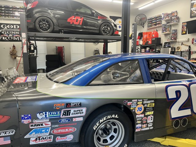

Your input appreciated. Picture for attention . . . as she sits now and likely will sit until this goat rope is resolved.

That’s solid. Also, what’s that race car?
It’s an old ASA car that was converted and run in an SCCA GT2 series for a few years. Just got it in the fall and haven’t run it on track yet, as I was prepping it and performing some much needed maintenance.
With the FiST sidelined, that car will be hitting the track soon.
