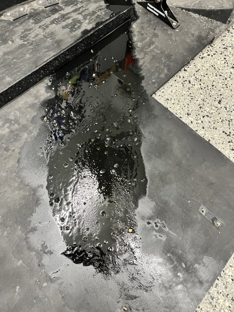

Nevermind. Just found a bad gear oil leak. Apparently coming from the input shaft area, as it’s traced to where the transmission meets the motor. I assume the seal got goobered up during the 4.3 and/or LSD install. Whole transmission has to come down again. I also have to be concerned with fluid on the clutch. Yay, me.
The attached picture is the top of my splitter (shown after removal, ignore the rocks). It’s a lot of fluid.
FML
Man, that sucks!

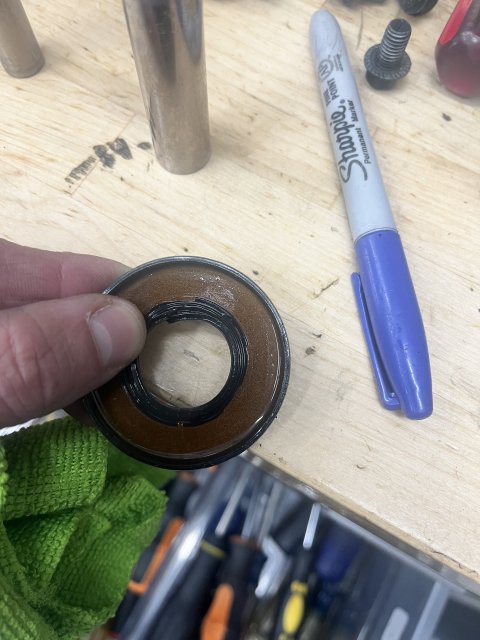

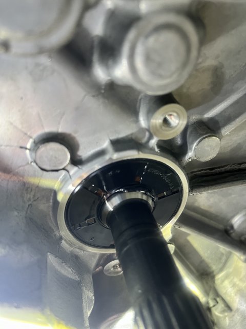

And the culprit. They definitely goobered up the input shaft seal. Oil was everywhere, including the slave, pressure plate, and arguably the clutch disk.
While I’m out my time and aggravation to pull it down, it does sound like they are going to reimburse me for fluids, seal, clutch//plate, and a slave.
