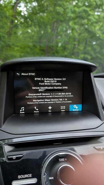

I'm interested in learning more about this too. I just picked up a 2016 FIST and downloaded the lastest version of SYNC directly from Ford on USB. It took 2 days of driving for it to finish the update. It's showing version 3 now. However I can not get my Pixel 8 Pro to bring up Android Auto. To my knowledge we don't have to install a new USB hub for Android to work. I've tried different cables and even the cable that I use daily for Android Auto in my 2020 Ranger and still nothing.

I downloaded the updated SYNC file for my VIN # from Ford.com I didn't know there was another resource. Ford.com had me download version 3.

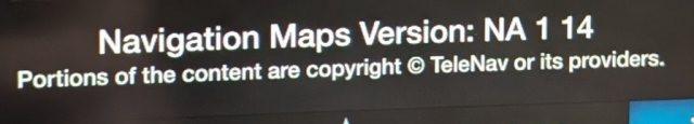

Does this mean non-nav version?
If so, you were fortunate just have not bricked the thing.
My car has navigation. But I did not update the maps. I have no need for the maps, so I just downloaded 3.0 from Ford.com to update the software and not the second file for the maps. NA mean North America.
I am going to try and update to 3.4 from Cyan Labs this evening and I'll report back if AA works.

Happy to report downloading the latest version of the SYNC update from Cyan Labs worked and Android Auto is fully functional. I do get a warning that the USB hub is not compatible upon start up but once I close the warning it works as it should. Thank you for letting me know about the Cyan Labs work around. If anyone did what I did and downloaded the update from Ford.com first make sure when you download Cyan Labs update that you put the exact version of SYNC that Ford.com provides as the infotainment screen is just going to say "3.0" when the version I downloaded was actually 3.0.23219.
