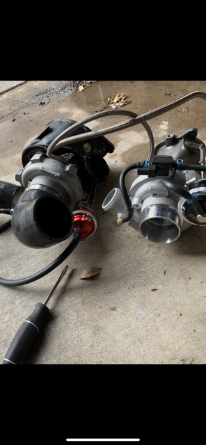

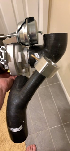

I just removed a gen 2 2860 to install an S280. This is turbo setup #6 for me (cyborg, c39, dhm 360r, rt330, atp gen 2 2860), and easily my favorite so far. Taking measurements last weekend, it’s essentially a 2860 compressor side and exhaust wheel, but with an oem style adapter less bespoke hotside, with a much smaller A/R (looks to be sized very close to the .52 A/R tial housing from my dhm kit). Spool is coming in 300-400 rpms sooner than my gen 2 2860, and airflow logs show it moving exactly as much. Dialed in with the 4 port on it’s going to be a flat out killer setup. It’s what the rt330 could have been, plus more. Everything for install down to the firering is in the box, very trick little setup for the bov/bpv, just a nice setup. Especially at its price point.

Install is complete, then got tied up doing a turbo install for local guy. I’ll get it out this weekend and start my logs.
