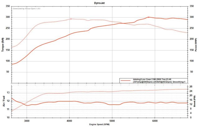

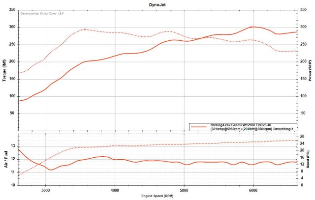

Just finished my E50 tune since installing my XDI HPFP and paired with my 30% injectors and I’m making a beastly 300whp according to vdyno…. Car feels slower than my stock HPFP setup. How is this possible lol.
Different tuner or same as before? Wonder if you have boost by gear now and didn’t before?
Same tuner. I also did a 4th gear datalog and the power was a little lower compared to 3rd. I was expecting some wheel spin in 3rd but nothing. I’m currently tuning with a different tuner that I also have and will see what happens.

Why is your whp so low for e50? Shouldn't you be around 330-350 whp at 28 psi? Your tune seems pretty conservative at 26 psi.
