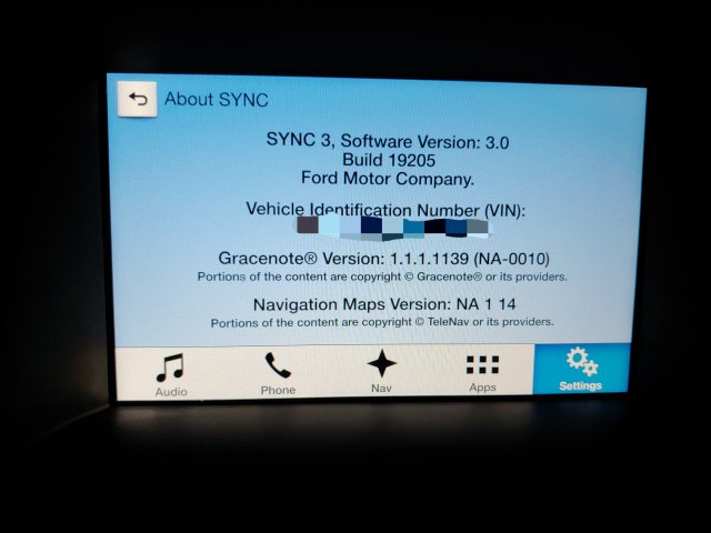

I'm having an issue with Android Auto on version 3.0 Build 19205. I purchased a 2016 this weekend (build date 02/16), which came with Version 1.0 and had no AA. I updated to 3.0 this weekend, but AA is still not showing up at all.
I have done a Master Reset, tried 3 different USB cables, reinstalled AA on my phone, re-installed the 3.0 update, and still nothing.
My phone will communicate and play music over USB (I disabled BT to be sure it used USB) to SYNC 3, but AA does not work at all. I dont even have the icon in settings.
I have used this same phone on a 2019 Fiesta rental with SYNC 3 and AA about 2 months ago without any issues. Any ideas?

I see the issue I believe, it looks like the update did not successfully process. Your NAV icon is still the older version, not the 3.0 version. On 3.0, the NAV icon looks more like a arrow pointing up.
Was this an official Ford update, or one found online?
See if you can downgrade back to 2.2 with files found online. V 2.3 has checks in place that prevent downgrading, but V 2.2 should work without issue. Then upgrade back up to 3.0 if you still want the latest version.
Edit: Your hub should not influence this issue, AA should work even with the older hub.

I do find it odd that yours is registering the update in the "About SYNC" page, as well as having the proper updated GraceNote version.
If it was me, I would still look into downgrading to version 2.2 and see about updating to 3.0 from there. YMMV

Just wanted to say thanks again to averyislost. I downloaded some random V2.2 files I found on a dropbox site (didnt realize there was a link in the OP of this thread, oh well). Finally got around to trying it last night. Let the update process for an hour and it never said complete, so I gave up, but this morning when I started my car it said an update had been applied. Now the about page shows V2.2, and AA is working! I also have some minor UI changes like I noticed a signal strength icon for my phone when paired with Bluetooth. So looks like 2.2 actually worked.
Will now try to go to 3.0 again tonight, hopefully that will actually work this time.

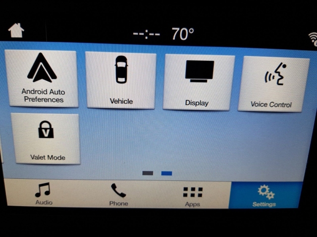

Version 3.0 Build 19205 I downloaded in December is now installed! New nav icon and all.
