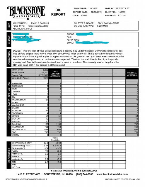

Had an analysis done for the first time on my ST, NAPA brand 5w30 with their gold filter. Was surprised they recommended longer intervals of 8k, the way I drive the car in this Florida heat I was expecting worse.
