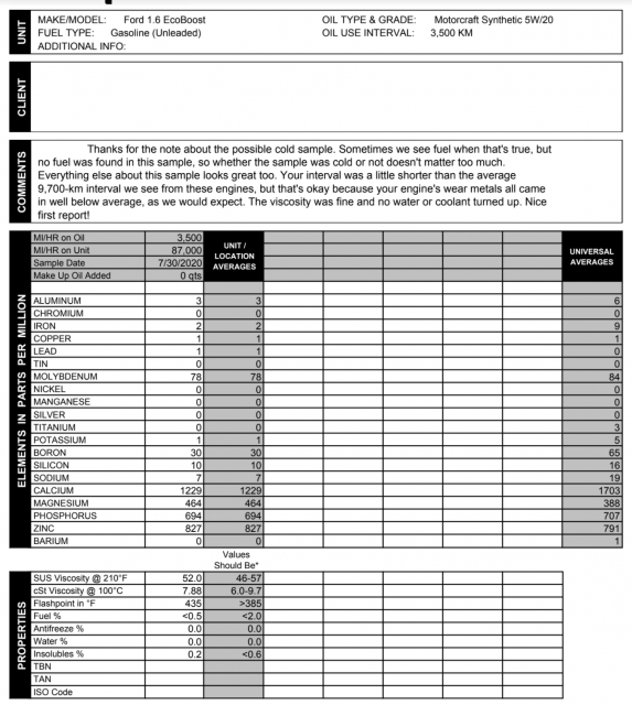

Been hearing all sorts of noises for a while, so decided to send in a sample. Report came in today; odometer is at 55k miles. Used Motorcraft semi synthetic for about half of them, then switched to Motorcraft full synthetic. So, hopefully it's mostly crappy pulleys.
