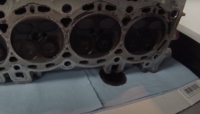

I watched an old T-Shirt Driving video I remembered from a couple years ago. He had Deadhook remove the head to check for a bad piston... When they pull the head and sett it down... you see oil draining from the larger galleys which are on both the exhaust and intake side... I think. this its completely possible honestly.. and I may be riding on a single keeper right now...

I just had a very similar discussion. The only way for that keeper to escape is up and it would be a very rowdy exit... it’s just not possible unless have a busted cam bucket and spring but even then... I don’t think clearances are big enough.... thanks for the link!

BIG UPDATE:
Removed the cams and…. IT WAS A SPARE! Great job FORD QC TEAM!
Meanwhile we did the major 100k+ miles services with timing belt assembly, water pump and several gaskets plus I serviced the injectors. Engine is running great and had all its keepers the entire time.
Some will say “told ya”, but hey… I wanted peace of mind and I had to help to save money on what would normally be a costly service job.
