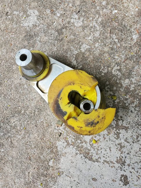

An update: after it violently popped on me last Thursday shifting from 1st to 2nd, I asked the techs and service adviser at my job to put it on the rack, and the tech discovered my RMM had disintegrated. Replacement bushings arrived today.
That's pretty spectacular. I guess that's one downside of poly bushings over rubber OEM ones...
Exactly. I went back OEM for a while. Not sure when I'm going back to the aftermarket.
