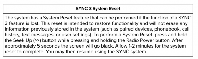

You could try a system reset for Sync 3, if that's the system you have. You press and hold the seek up button while pressing the radio power button. It's worth a try, and doesn't lose any of your settings if I remember correctly.
Or just pull the number 10 fuse for a bit. It sometimes works better than the master reset.
