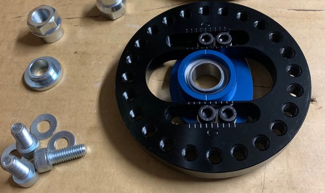

I installed Swift springs and had no clearance problems. Looking for more camber, I installed CompBrake adjustable top hats and got about 2 degrees negative camber. I have some rattling or knocking noises over small bumps. I raised the front end, and turned the wheels lock-to-lock. Turning to the right, I heard binding. I pulled the right wheel and saw that at least two of the coils were contacting the inner side of the strut tower, and the undercoat was worn off the tower at the points of contact. No similar problem on the left side. I used a hard dowel and deadblow hammer and pushed the sheet metal slightly away and the binding is gone. A slight reduction in camber (moving the three top studs outward) would likely have the same effect. Unfortunately, the knocking sound continues and I'm looking into that.

^^^Are you still on factory style dampers with rubber bushings on the actual mounting points?
Or did you install something with spherical bearings/bushings on those mounting points??
(I know about that CompBrake top mount's bushing setup, but the same on the bolt through actual damper mounting points will cause even more knocking, even on relatively smooth roads. [:(])
On the stock struts, I replaced the stock springs with Swift springs and the stock top hat (dished triangular plate with rubber center mount and three studs) with the CompBrake top hat with and adjustable/sliding spherical bushing, mounted to the chassis strut tower with three bolts from above, through the tower holes into the CompBrake top hat.
I've adjusted the negative camber from 2.25 degrees down to 1 degree, but the knocking over speed bumps and some smaller bumps continues. I've detached both sway bar end links, but those were not the problem.
I've noticed that the stock top hat, with its dished shape puts the large rod nut lower than the CompBrake nut/bushing. That might add more preload to the spring, but I don't know if that could cause the knocking.

It is hard to tell from that pic, but are those CompBrake top mount's spherical bearings lined (between the damper shaft contact part and the outer mounting casing) in any type of Delrin, or other hard plastic liner material??
If not, and purely ALL metal, I would expect them to make a bit of noise over any (even tiny) bumps in the road.
#24629
103
72
Thanks M-Sport Fan. Yes, the bearing is all metal. I understand in general why an all-metal bearing would transmit more road noise (NVH), and I understand that as bearings wear, tolerances will increase and the bearing will make noise as the center closes a gap and contacts the shell. But I don't understand why a brand-new bearing that has no free-play and is difficult to rotate in its shell, could move enough to make a metal-on-metal clacking or banging sound.
Today, I adjusted the top hats to have zero camber, just to eliminate possible spring/tower or other clearance issues. This is less camber than before I installed the solid top hats. I previously had about 1 degree negative, with the stock struts, Swift springs and camber bolts. From below, now I can see the clearance between the springs and towers, but the noise continues. Of course, that is with the suspension in "full droop" on jackstands. I can't see into the tower with the car on the ground and the suspension partially compressed. I've tried a jack under a control arm, but I can only compress the suspension so far before that corner starts to lift, instead of compressing the spring more.
As you’ve picked up, it’s probably not the bearing making noise, but it is transmitting more shock through the interface. A lot of the NVH it comes from road contact, but also stuff like the sway bar/end links and control arm vibrating.
However, what you’re hearing or feeling could just as easily be something on the car body side between driver and the shock hat that is now rattling because of the increased vibration transmitted into the engine bay. So if nothing on the suspension assembly seems to be the direct cause, start looking around

Thanks so much, Dialcaliper. That makes much more sense to me. Given the checks and re-checks I've done, it seems very unlikely at this point that it is the strut unit (including solid top hat) that's making the noise. I've spent some time tightening engine mounts, subframes, cross-braces, sway bar mounts, etc., and will focus more on the rest of the front chassis. I'll check the control arm ball joint and inner-end bushing; inner and outer tie rod ends; rack mount bolts; and remove both sway bar end links completely, rather than just disconnecting one end and zip-tying it in place.

The sound I was hearing was more of a clack or tap than a clunk, and it went away when I reverted to stock top hats. I'm convinced that the adjustable, spherical top hats themselves were fine, its just that they increased NVH enough to amplify regular chassis sounds, or maybe introduce a new one that was laready on the threshold.
However, when I first installed the Swift springs with my oem struts and top hats, the springs were contacting the inside of the strut towers. That was a different sound, more like a bang, on compression. As mentioned above, I massaged the inside of the strut towers and took care of it. There's plenty of room for that mod.
