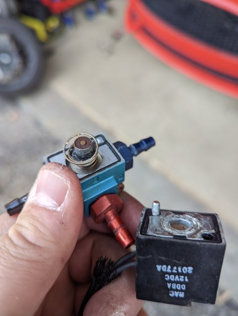

Anyways, my car recently had issues where the valve would get stuck open and car stopped building any boost past wastegate pressure.
The culprit? The solenoid had rusted and was no longer functioning (see photo). I had to pay $45 for a replacement. This was after about 3.5 years of install.
Just a warning, especially to those (like me) that have this valve and live in snowy/salt conditions
