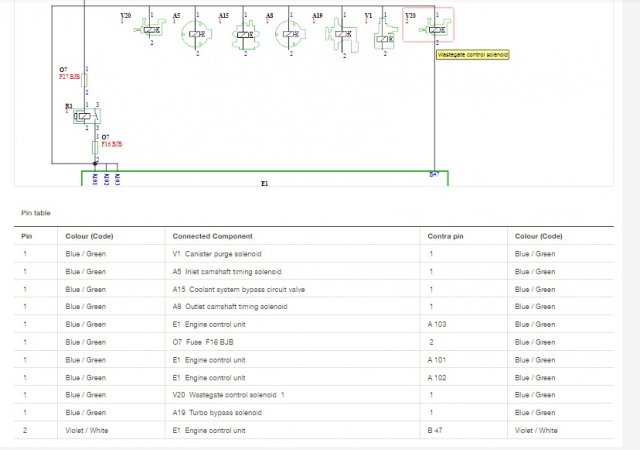

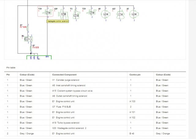

You can see on the pictures below, of the wiring diagram, that there are 2 wastegate solenoids. V20 solenoid 1 & V20 Solenoid 2.
Solenoid 2, is the one that sits on the turbo and is connected to pin B47 on the ecu via the violet/white wire.
My issue is that I am trying to locate Solenoid 1, this is connected to the ecu on pin B46 with a grey/orange wire.
This would seem to be the one that I need to find, as all the other ones and wiring are testing okay.
