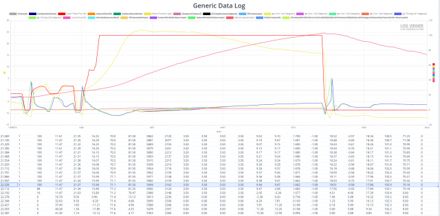

I'll upload some logs but it appears im getting some ignition correction around full throttle and 3000-3500rpm. I'm assuming it's a fouled spark plug so I'll pull those today, but if anyone has any suggestions let me know.
https://chadneu.com/cobb-log.csv is the latest log. You'll see around lines 200 that I get a good amount of correction. This manifests, while driving, as a slight bog. It quickly recovers and doesn't happen above 4000rpm.

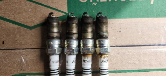

Here are my plugs. 1-4, left to right. New plugs are in, gonna go do some pulls with logs enabled. Hopefully this fixes it.
I find it interesting that 3 and 4 seem to be leaking some oil or they're getting pretty hot. That discoloration aint great. My car never overheats or show signs of being too hot. I have a trip pass rad in there.

Aaaand new plugs fixed it. I did a bunch of 4th gear 2000 to redishline pulls so I'll upload the logs for anyone who wants to dig around em.
edit: https://log.tunezilla.com/s/mGVfx6yD https://log.tunezilla.com/s/6En3d87y https://log.tunezilla.com/s/WtucRZIW No bogging or anything anymore, but still some adjustment. I figure that's normal? Input from others?
Oh, also, when I pulled the old plugs they were all gapped to around .030 which is a bit too large. That could have been doing it. All the new plugs are gapped to about .026". Now I'm just waiting on Jason over at Dizzy to send me the v3 tune.

Some small positive corrections is a good thing. I’m no expert, but those logs look good to me
Absolutely. New plugs fixed it tho and the timing correction got a bit less frequent. So I'm assuming the gap was a bit off and was causing a tiny bit more correction than was necessary, resulting in a specific bog in that RPM range.

The first thing I thought about ur plugs was "Dam that gap is big". How many miles on the plugs? And were they iridium?
