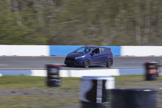

So it's been about a year since I got my 2016, and I just put on a Whoosh V1 IC and got a dizzy tune. For the first time since getting the car, I don't know what to do next with it. Any suggestions? I am building this car for track/autox/spirited road driving, but have a tight budget.
So far I've done: Wheels and tires, some skirts + small aero bits, Bilstein B6s, Cobb RMM, Thermal Catback, Cobb intake, AP, and the aforementioned FMIC + tune.
I've been considering a catted DP, a short shifter + knob, GFB DV+, Swift Spec-R lowering springs, camber bolts/plates for the fronts, traction bars, upgrading to a Recaro interior, and finally going upgraded turbo(would have to save for a while). Are there mods that I'm missing, or some that I should prioritize? Thanks for any input!
