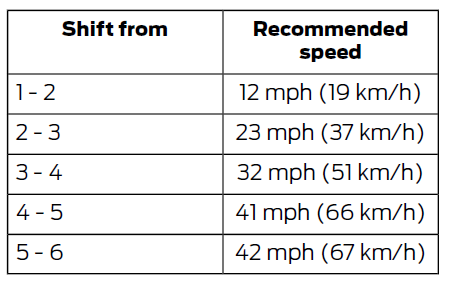

Oh that freaking light is the dumbest thing I’ve ever seen. I read in the manual that it suggests shifting at
1st to 2nd-12 mph
2 to 3rd- 23 mph
3rd to 4th. 30 mph
4th to 5th -40
6th gear is Anything over 40
Which is way below the typical rule of thumb where ever gear is 10 mph. If you go by the typical rule. You would shift into 6th around 60. Not 40
1st to 2nd-12 mph
2 to 3rd- 23 mph
3rd to 4th. 30 mph
4th to 5th -40
From the manual...
