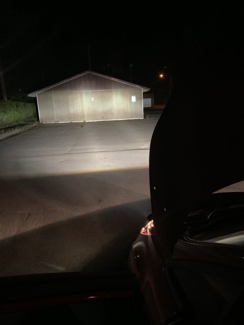

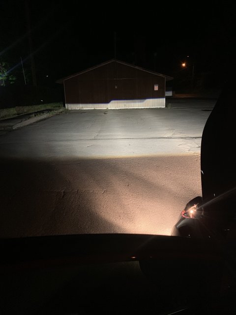

It’s seriously easier to retrofit them with some projectors. You can easily do it in an afternoon start to finish. I did mine in about 7 hours from opening them up, installing, adjusting and aiming and resealing. I even painted them-let them dry for 24 hours though. But if you didn’t paint, would probably be less time.
I’d be happy to give some pointers if interested. I could even entertain the thought of completing the service for a fee. Depending on interest. It’s labor intensive though, but not hard and output is significantly increased. Top is high beam and bottom is low beam.
Adding higher wattage bulbs is not going to fix the problem. It’s just a band aid
6AAF3F87-CE34-4805-9824-97643CC99213.jpeg 30E62F02-AB2B-4E78-9F83-0B74578DFADD.jpeg
View attachment 22511 View attachment 22512
How did you go about opening yours? I cut one of mine open and I'm debating on doing that to the other side or trying to pry it open with heat.
It’s super easy to open with heat. The rights tools help immensely. The worst part of the process is cleaning out the permaseal. Once that’s done it’s all gravy.
Permaseal can be opened with heat? Wow, didn't know!
Heat gun or oven bake? I was gonna try small flathead screwdrivers with a heat gun, but I mean the dremel made pretty quick work of the other lens, you'll never see the seam, I just dont know if it will seal.
Oven bake is what I did. I’ve done 5 retrofits so far in the oven and each time has turned out well. I have not done a dreamel and hot knife.
To seal it you need to melt the plastic back together. A hot knife comes in handle with a spreader attachment like a screwdriver almost. Plastic welding is what you are doing.
So if i plastic welded it, it would likely be fine? I have access to one of those interestingly enough. I'll try baking the other one, any suggestions for that?
Check out lightwerkz for some how to videos. I have used them for most parts and instructables.
A lot depends on your oven and if it even fits.
