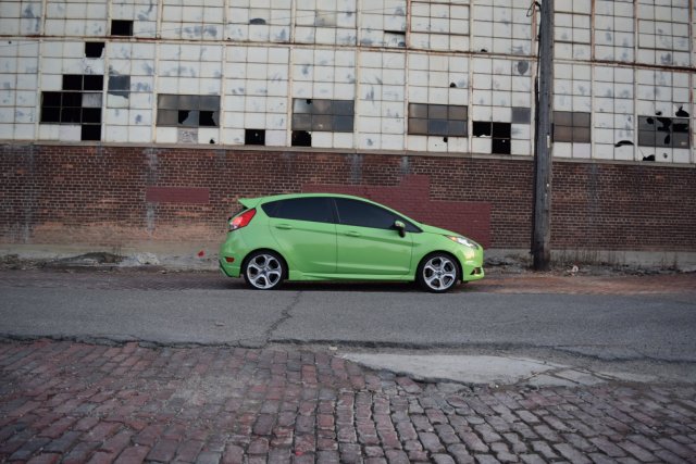

Ohhh I know all about that.. also owned a Acura TL and had to replace that. Did get a Ford warranty so maybe it'll help out. My car I traded the ST in for below View attachment DSC_0233.JPG View attachment DSC_0038.JPG View attachment DSC_0130.JPG View attachment DSC_0176.JPG
