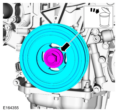

Hey folks. I'm changing the timing belt and water pump on my '15 (about 130k miles) while I have it torn apart for some other stuff. Can anybody confirm what parts I should replace in the process? Here's my list so far:
Water Pump - Product ID: 7S7Z-8501-C
Gasket - Product ID: BE8Z-8507-A (water pump gasket)
Timing Belt - Product ID: BE8Z-6268-C
Tensioner - Product ID: BM5Z-6K254-A (timing belt tensioner)
Serpentine Belt - Product ID: BM5Z-8620-B
Crankshaft Pulley Bolt - Product ID: BE8Z-6A340-A
I'm wondering if I should proactively replace these as well:
Tensioner - Product ID: DS7Z-6A228-B (serpentine belt tensioner)
Serpentine Idler Pulley - Product ID: BM5Z-8678-A
Is the intake manifold gasket reusable or should it be replaced whenever the intake manifold is reinstalled?

The manual should identify items that require/recommend replacement; either via Maintenance Schedule (like the timing belt) or in the course of service. For example...
Your list is good. I also had the thermostat and housing changed while everything was apart. I had my dealership do it so I'm covered under warranty for their work. No complaints so far. The mechanic has over 28yrs of engine building under his belt!

It's below the alternator, which has to come off for the timing belt job as well. So pretty much yes, as long as you don't mind dealing with the coolant mess on top of everything else.
