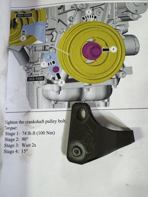

Issue 3 : Pulley alignment tool
You need to remove the crank angle sensor to install a special tool to precisely place the crankshaft pulley.
This tool needs to be inserted below.
Once you have torqued the bolt in place, the manual simply tells you to unbolt the tool and slide it out. However, this is **not** possible. The tool is first inserted into a hole and then placed over a hollow cylinder where the sensor was located upon. Check the bellow image for reference.
Even with the bolt removed, in this configuration, you can't even budge the tool. What I had to do was crush this small cylinder inwards with a flathead screwdriver to be able to rotate out and wiggle out the tool.
Once I had the tool removed, I deformed back this cylinder to be able to accept a screw, but it was still damaged by doing so. The crank angle sensor went in fine, and it did not affect anything else.

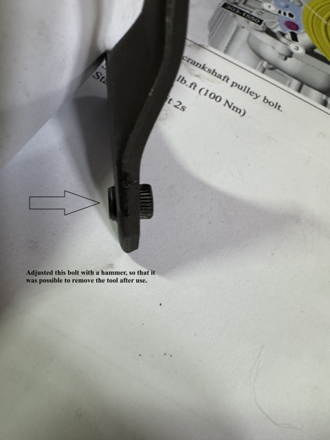

Thanks for the warning, Issue 3 : Pulley alignment tool
I tried a little before tightening the crankshaft pulley and found that by adjusting the tool a little I got it loose after the job.
