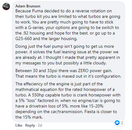

Found what I was talking about .....It was on a FB post where he talks about how this turbo is likely out of steam.
Well that's good, now I know that won't work for my situation 🤣
