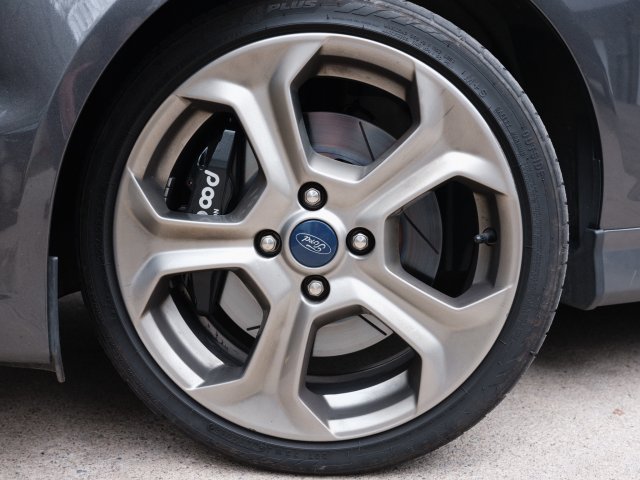

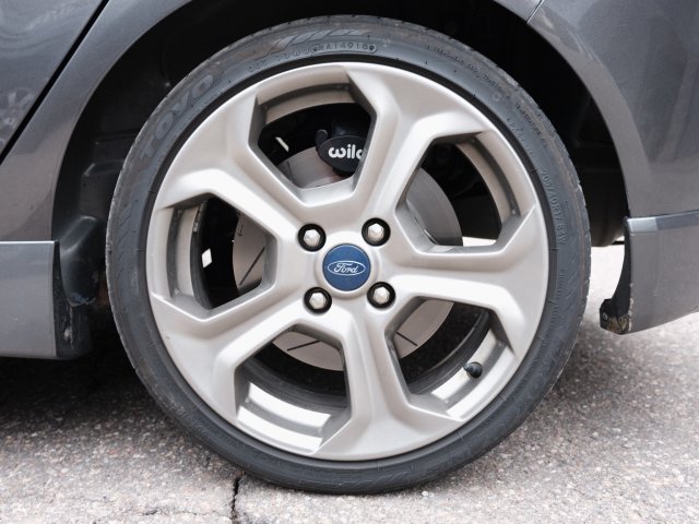

Stock Fiesta ST 17x7: clears everywhere, but the front caliper is very close to the spokes. It probably wouldn’t hurt to shim/cheat the caliper inboard slightly to maximize clearance there. (Or maybe run a thin spacer if you really need to, mine didn’t need it) E12E596B-B511-4EEB-A8B4-A7A187F2414E.jpeg 9F7E5719-ED62-4DCC-8037-88043B191490.jpeg

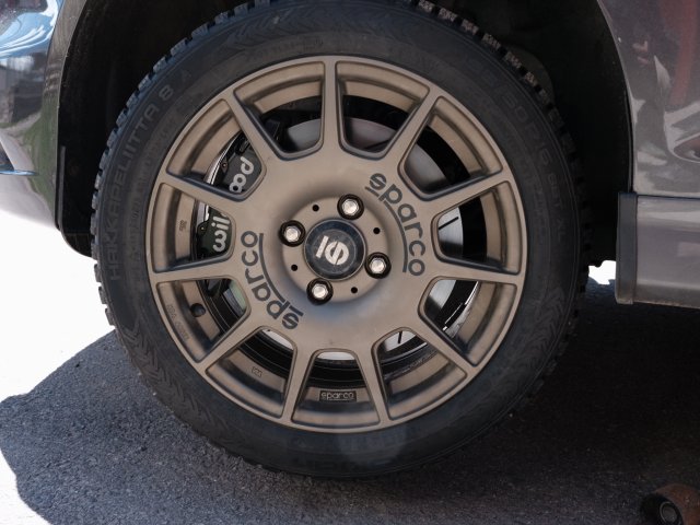

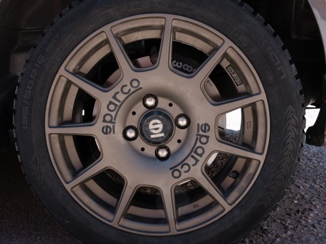

Sparco Terra 16x7+42: clears everything, but if you have weights on the inside just behind the spokes on the rear wheel, they will have to be relocated because the caliper will just hit them AEE86FC1-B8B6-4AEE-9DC8-9A1EA72F4554.jpeg 44FBEFF2-3974-4B7A-A76E-642DD2CF7A06.jpeg

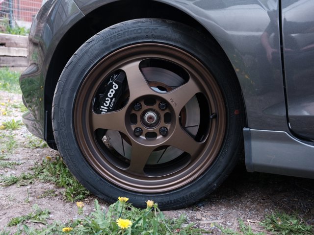

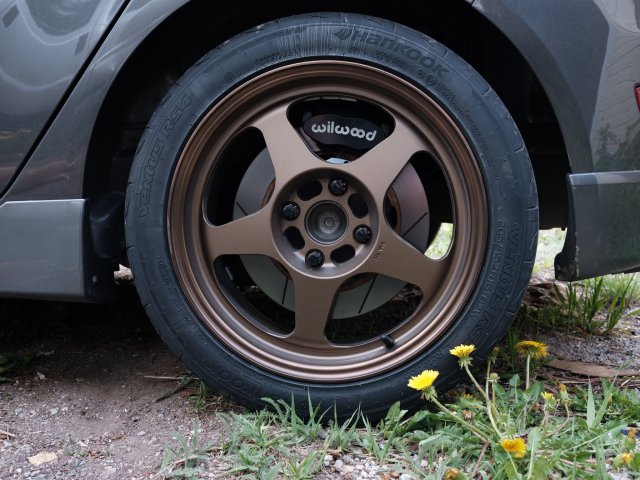

Enkei RPF1 16x7+43 4x108: fronts will clear, with 8mm spacer, rears are not even close. This wheel is about 14.25” inside diameter, pretty close to the 15” steelie spare that comes with the car

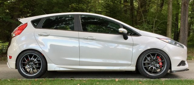

Team Dynamics Pro Race 3 (17x7 +38) - clears with lots of space, no modifications needed.
Konig Dekagram (16x8 +40) - also clears, wheel weights get close but do not touch, maybe 1/4" clearance.

17x8 6ULs fit with lots of room to spare on the front. I don't run Wilwoods at the rear.
Any pics of it with these on (guessing that they are an open track setup [dunno])?
Believe it or not, I actually do really like the aesthetics of the 17" diameter and up 6ULs LOL, just not the looks of the very short spoked, 'they will float up to the sky like a hot air balloon without tires on them' zero gravity, 15" versions. [wink] [thumb]
This is before the larger rear rotors. Not an open track setup, but pretty much just a track-day car these days.
