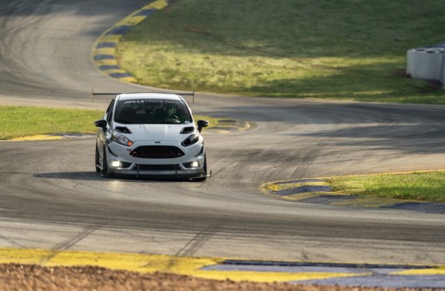

My car is giving me headaches. It keeps blowing the 10a F24 “emissions” fuse under the hood coming out of the same turn at Road Atlanta. I’ve replaced the EVAP solenoid and checked all the grounds and wires and cannot locate the short. I’m convinced a short is the problem because it only happens in that part of the track if I’m passing or being passed and touch the outside curbing. I’m not sure what to do besides pull the entire wiring harness out and open it up. Mechanically it’s been so good (and still is) but some wire somewhere is driving me nuts.

Maybe a chafed wire that keeps touching bare metal everytime you get the G Forces's driving into that corner
