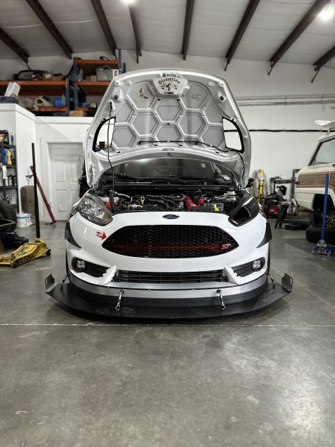

Had an issue with the car throwing a CEL then dying on track Sunday after a great full day Saturday. Codes P0245, P025a, P0443, P26BD, U0109. All a result of F24 emissions fuse blowing under the hood. I found two small exposed wires under the intake hose that connect to the coolant BPV that might’ve been the culprit. Taped them up, replaced the 10a fuse and the engine fired up again without codes. Ready to roll again. Thankfully it wasn’t anything major.
