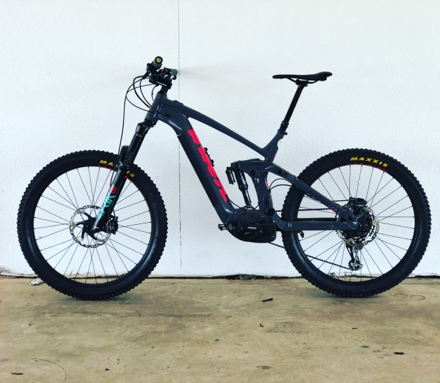

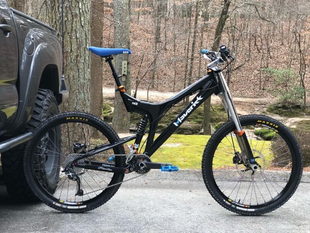

I forgot that they even had disc brakes back then, since no road bikes had them in that era. [wink]
Yeah, sweet downhill/rough general riding rig there! [twothumb]

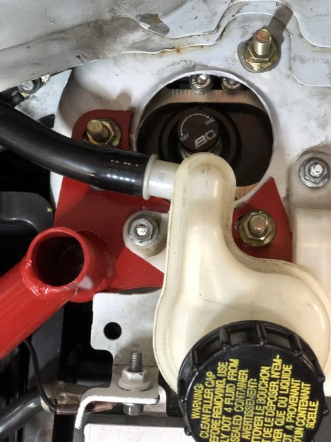

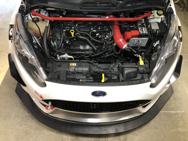

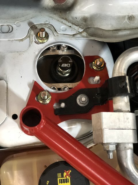

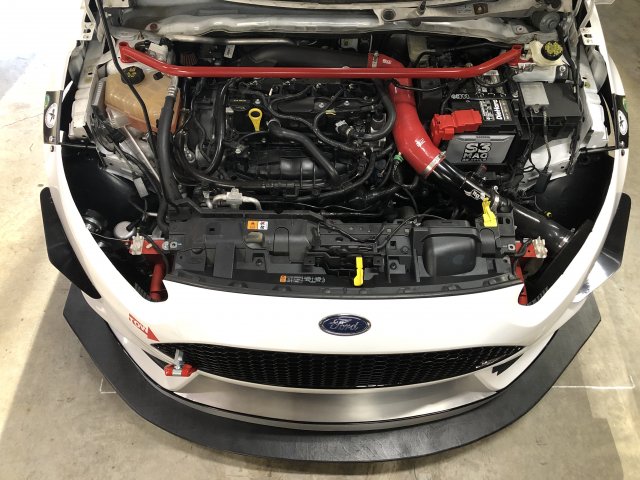

Installed a new Pierce front tower brace today. I drilled out the top of suspension mounts so I could access the hardware a little easier so I figured I’d add a brace for peace of mind. It’s probably good without it but I’d rather not find out the hard way. Don’t judge my rattle can paint job. 😉
